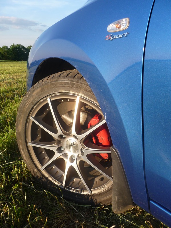

Pridavam detail novych disku. AEZ Tidore Dark 7x17 ET40 a pneu Bridgestone Potenza 225/45R17
- P1020048.JPG (130.77 KiB) Zobrazeno 2042 x
