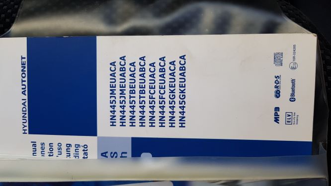

Ahoj všem, pořídili jsme domů Tucsona a je v něm rádio s Bluetoth - viz foto - a rád bych spároval s mobilním telefonem, a nejde mi to, ač to dělám dle manuálu sice německého ale dle popisu. Poradí někdo prosím???

Hi to everybody. I do not want to try to write in your language because translating with a Google Translator will be funny. I have the same player, but I do not have a microphone installed in the car. I have no manual for this player and I do not know where to connect it. Is there any manual for the same player and can it share it. The my player is Hyundai Autonet HN445JMEUABCA. I have a phone iPhone 6s plus, which I paired without deleting anything because I don't know where this menu in the player might be.Thank you in advance.
